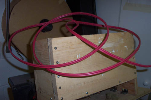

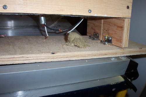

Hi folks, i'm trying to wire up my side bender but don't want to short the box, if you look at the pics below, there's a red type of wire it's romex, red & black inside, is it any good for my bender? There are 3-200 watts light bulbs. mouunted on ceramic fixtures and 3" insulated round boxes under the fixtures. I was also thinking of plugging each light separately in a power bar along with a electric timer. You're input would really be appreciated, if you know how to wire this properly and safely.

You red wire looks like it should work, however, you would be better off safety wise to use something that also had a ground wire in it. Also check the guage of the wire. Here in the states it should be at least 14 guage. Not sure how it's rated up north
Don't skimp here. Safety is a major concern. Find something with a ground wire in it.
The plug stip is not a bad idea. They usually have a breaker built in.

I believe the Romax should be grounded wire, Make sure you use it, especially if you wet your sides. Here in Canada code calls for at least 14/2 grounded wire, I believe you have 12/2 so you are fine. If you arn't familiar with wireing though find someone who is, you don't want to be messing around with this.

Thanks Ronn and Richard, i'll be heading back to my shop to read what is written on that wire, but i think i saw 3 wires in it so there should be a ground one. If each bulb is plugged separately on a power bar, do i still need that red wire though? Wouldn't it simplify the wireing so that i can decide on how many bulbs to plug in at one time on the power bar?

Serge, That looks a bit like wire for underwater. You see it in submersible well pump situations.
As for the ground, you probably noticed there are only two wires on your fixture, so the ground is for grounding the box in case a hot wire pops loose it shorts and throws the breaker.
In your pics, I don't see the boxes? Your wiring connections are made up inside the boxes normally. I can't believe you have porcelain base fixtures with wire leads, those are rare. I really like them, only seen them one time in 35 years, usually there are two screws, a brass one (hot) and a silver one (neutral) in a 110V. circuit.
A simple diagram is all you need to hook that up. It's wired in parallel, black to blacks (hot) and white to whites (neutral). 110V.
The wire in the pic is most likely not high temp, even on the fixtures. It would be best to have the wiring outside your box, and just have the bulbs enter the chamber, honest. I'm redesigning my next bender as I type this.

From North Western Ontario Serge. Funny thing is that it costs more to Fly from here to Toronto (while not here but if I drive a few hours to Thunder bay) than it does to fly from Halifax to Vancouver. Get your friend to look at it and I am sure he can wire it. It is a real easy job but always worth being safe on. And I believe that Dicky is right, Nomax wire is used with submersible pumps.

Only three hours from Longlac, We will actually be up there next month for my son's hockey tournament. The Nomax wire would work but is probably over kill.
